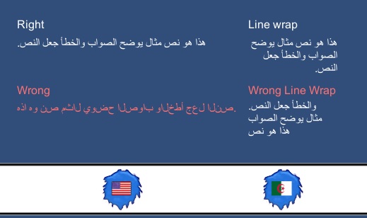

I just added a workaround to 2.6.1 for correct multiline wrapping with changing alignment.
As you can see in the screenshot, the correct version, starts on the upper right and aligns to the right.
This is a workaround until I get an stable method of querying where the different plugins (uGUI, NGUI, TMPro, etc) are going to split the lines.
I can inject my code in NGUI and TMPro, but it can get messy if they do big updates to their plugins.
In the meantime, this method works great for most cases.

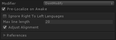

The Localize inspector now has two more options, one specifying the maximum number of characters that can fit in the label. I2L splits the text into lines with that length and applies RTL fix for each individual line.
The other option is a checkbox for adjusting the Alignment if the language is Right-To-Left.
It will make the text align to the Right when the language is RTL and to the Left if its not RTL. (Vertical alignment is maintained)

Also I saw the Max line lenght option. How can I easily adapt this to all lables in my scene? I saw that if I insert a value bigger than the length of the UILabel, the lines are still in a wrong order. Setting the max line length to a value smaller than the capacity of the label fixes them, but I have to go through a lot of UILabels in my scene which can be a bit of a nuisance.
Max Line Length is a property that should be modified per label, given that different labels will have different width and so a common length will not make sense.
An easy fix, is to multi-select at the same time all labels that are displaying wrong (just type UILabel in the hierarchy view and select them all) and write the length that works for you.
