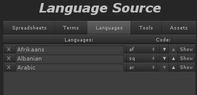

I don't see a way to choose the language you want to display in the Editor. I'd like to be able to select the current language in the Editor and have all the Localize scripts change to the selected language without need to play the game.
I just added a new button ("Show") at the end of each language in the Language list in the LanguageSource.
When you click the button, it previews all text/images/etc into that language.
