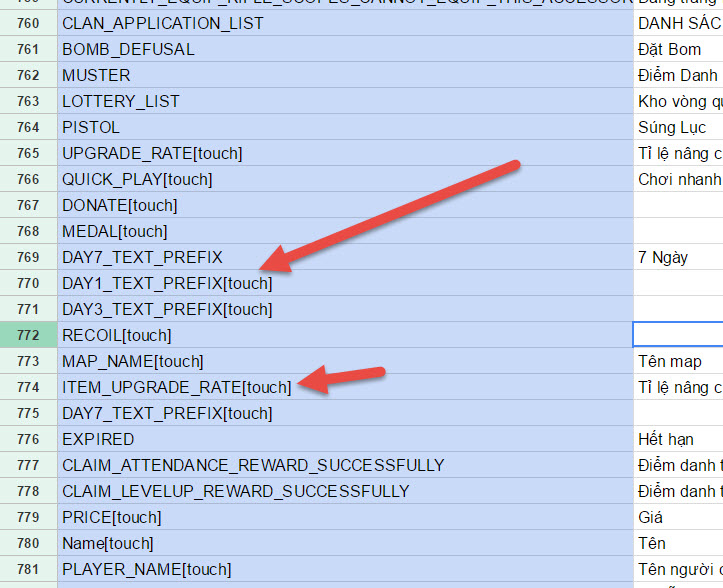

Change all [touch] keys to normal keys? was created by JOY
My dev accidently changed many keys fro normal to touch type and export back to the spreadsheet file. Is there any way to change them to normal key without [touch] suffix?

I'm refactoring how that works( trello.com/c/slJ2P9aM/3-extend-input-specialization ) (Touch vs Normal input works) to avoid this accidents and extend the input type to more uses.
But in the meantime, the easiest solution is to open the spreadsheet and select in the menu Replace All "[touch]" by "", then reimport the spreadsheet into Unity.

9 years 6 months ago #2148
by JOY
Replied by JOY on topic Change all [touch] keys to normal keys?
Will it still keep my implemented component value?

Replied by Frank on topic Change all [touch] keys to normal keys?
Yes, it will be backward compatible.
It will keep the same format that it has now, where the terms are tagged (e.g. "term[touch]", "term[vr]", "term[xbox]", etc). But the editor will change to make the selection easier to understand, and easier to clear tags when not needed.
At this moment, if you type something in the touch and something in the normal sections, it creates the tag, but there is no easy way to clear that selection and to know that the term was split.
The new inspector makes that easier to manage.
