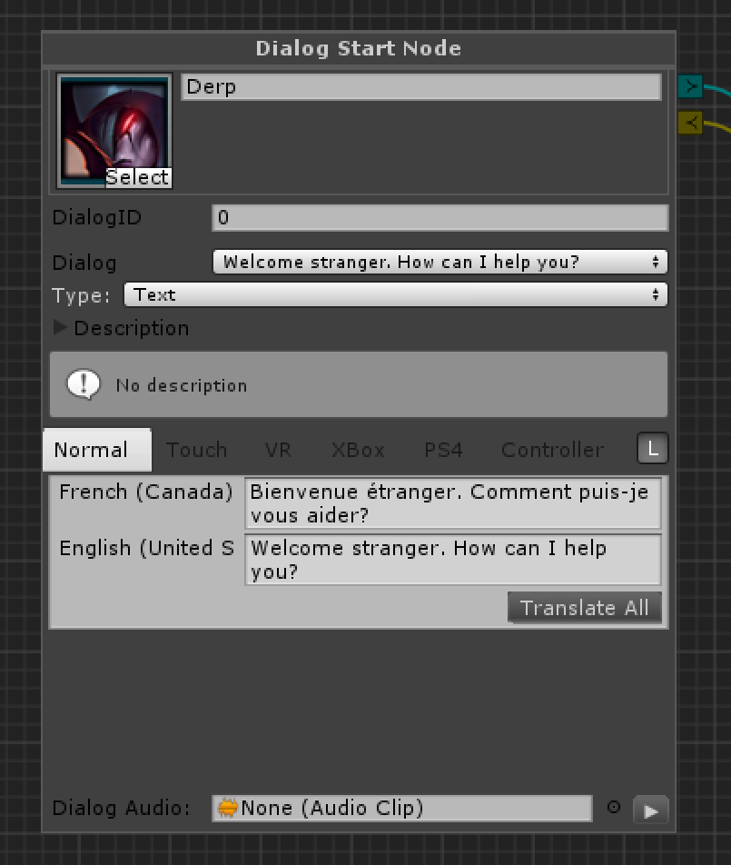

So I've attached the result from what I've done.
I've created a new script with your example above, but that is not under the Editor folder. I've put it outside of your folder too, in case you update, or I need to delete it to install a new version. The namespace is still yours in my script.
I had to add the Filter and DisplayOptions methods in my script (you have references).
And I finally used only that line (removed the Rect and GUILayout.Label).
this line didn't work:Do I also need to duplicate the script for that option? What is it doing?
Thanks for your help! That sounds so easy for you
ShowDialogNodeGUI.ShowGUI(ref DialogLine, new GUIContent("Dialog"), null);this line didn't work:
//LocalizationEditor.OnGUI_Keys_Languages(DialogLine, null, true);Thanks for your help! That sounds so easy for you
8 years 10 months ago - 8 years 10 months ago #2627
Replied by Frank on topic Editor Node - Dialog
Well, the issue there is that your code is been compiled before the Editor code, so it doesn't have access to that function.
You can implement a proxy function.
- create an static event with the same signature
static Action<string, Localize, bool> proxyOnGUI_Keys_Languages;
- then inside the editor folder, create an empty script with [InitializeOnLoad] and register the OnGUI_Keys_Languages function into that event. similar to this:That way, whenever you call the event, it will call the OnGUI_Keys_Languages function even though its compiled after.
instead of
You now do:
NodeDialog.proxyOnGUI_Keys_Languages(DialogLine, null, true);
That should work fine. Although its a bit more involved.
Another easy solution is to skip that inspector part and just put a button that opens the I2Languages.prefab to allow you creating a term.
[InitializeOnLoad]
public class ProxyRegister
static ProxyRegister()
NodeDialog.proxyOnGUI_Keys_Languages = I2.Loc.LocalizationEditor.OnGUI_Keys_Languages;
}instead of
You now do:
GUILayout.BeginHorizontal();
GUILayout.FlexibleSpace();
if (GUILayout.Button("Open Source"))
Selection.activeObject = I2.Loc.LocalizationManager.Sources[0];
GUILayout.EndHorizontal();Hope that helps,
Last edit: 8 years 10 months ago by Frank.
8 years 10 months ago #2631
by pete
Replied by pete on topic Editor Node - Dialog
Something doesn't work on my end.
I created the static action in the variable declartion section in my DialogStartNode.cs script
Then I created the script in the editor folder.
But, the OnGUI_Keys_Languages has the wrong return type.
There is probably something missing on my side.
The button is working as intended though!
Thanks for the help, almost there.
public static Action<string, Localize, bool> proxyOnGUI_Keys_Languages;Then I created the script in the editor folder.
using UnityEditor;
[InitializeOnLoad]
public class ProxyRegister {
DialogStartNode.proxyOnGUI_Keys_Languages = I2.Loc.LocalizationEditor.OnGUI_Keys_Languages;
}But, the OnGUI_Keys_Languages has the wrong return type.
8 years 10 months ago #2632
You dont need the return value, so you can call a wrapper instead:
or make it anonymous
using UnityEditor;
[InitializeOnLoad]
DialogStartNode.proxyOnGUI_Keys_Languages = VoidCall;
static void VoidCall(string key, Localize cmp, bool primary)
I2.Loc.LocalizationEditor.OnGUI_Keys_Languages(key,cmp,primary);
}or make it anonymous
DialogStartNode.proxyOnGUI_Keys_Languages = (key, cmp, primary)=>I2.Loc.LocalizationEditor.OnGUI_Keys_Languages(key,cmp,primary);Hope that helps,
The following user(s) said Thank You: pete
8 years 10 months ago #2633
by pete
I think it works
Let me know if you see anything wrong!
Huge thanks for your help!
