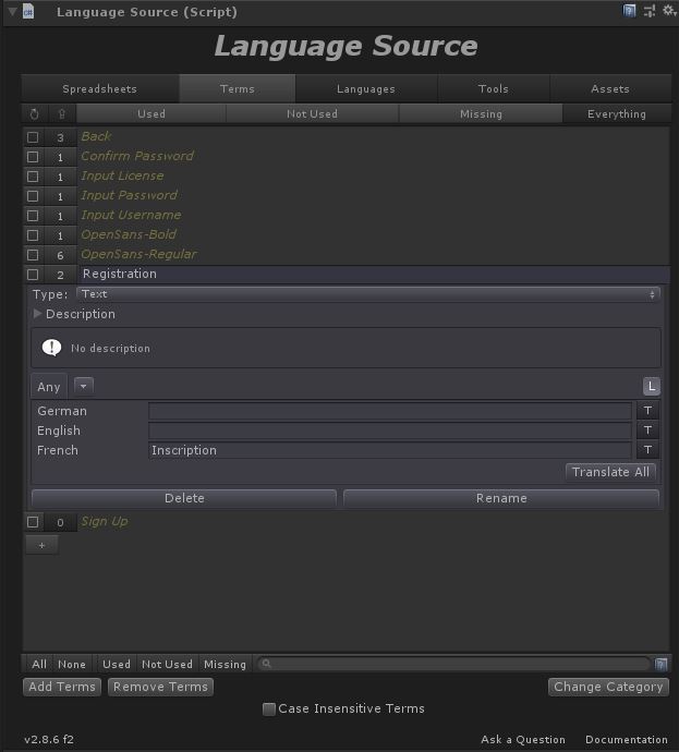

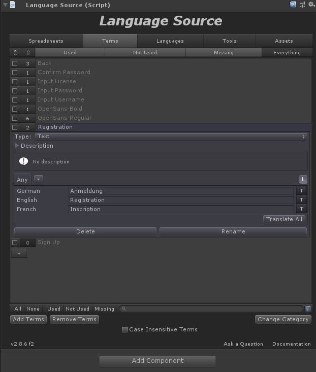

Hey,
I've run into a problem that I can't change any language anymore. I've got all my datas set up and when I'm pressing play, the terms with all the text inputs will dissapear and only one language (french) will stay.
I also tried to delete everything but I don't know what to do anymore. I attached two images where you can see what happens when I press play.

My bad,
Everything is working now. I just made a mistake with the language buttons. The On Click function had the french script and not the german or english script attached. So everything is working perfectly! The images didn't show an error - it's a normal behaviour that only the current language will be visible.

I'm glad you were able to solve the issue!!
When In Play mode, the plugin to save memory unloads all languages except for the current one. Then, as you change languages, the plugin loads the new one and unloads the previous language.
Said that, in 2.8.7b1, there is a new setting in the Languages tab, that defines where that memory saving happens (Never, OnlyInDevice, InDeviceAndEditor).
That way its easier to make changes in the Editor while in PlayMode.
As you said, that is the normal behavior.the terms with all the text inputs will disappear and only one language (french) will stay
