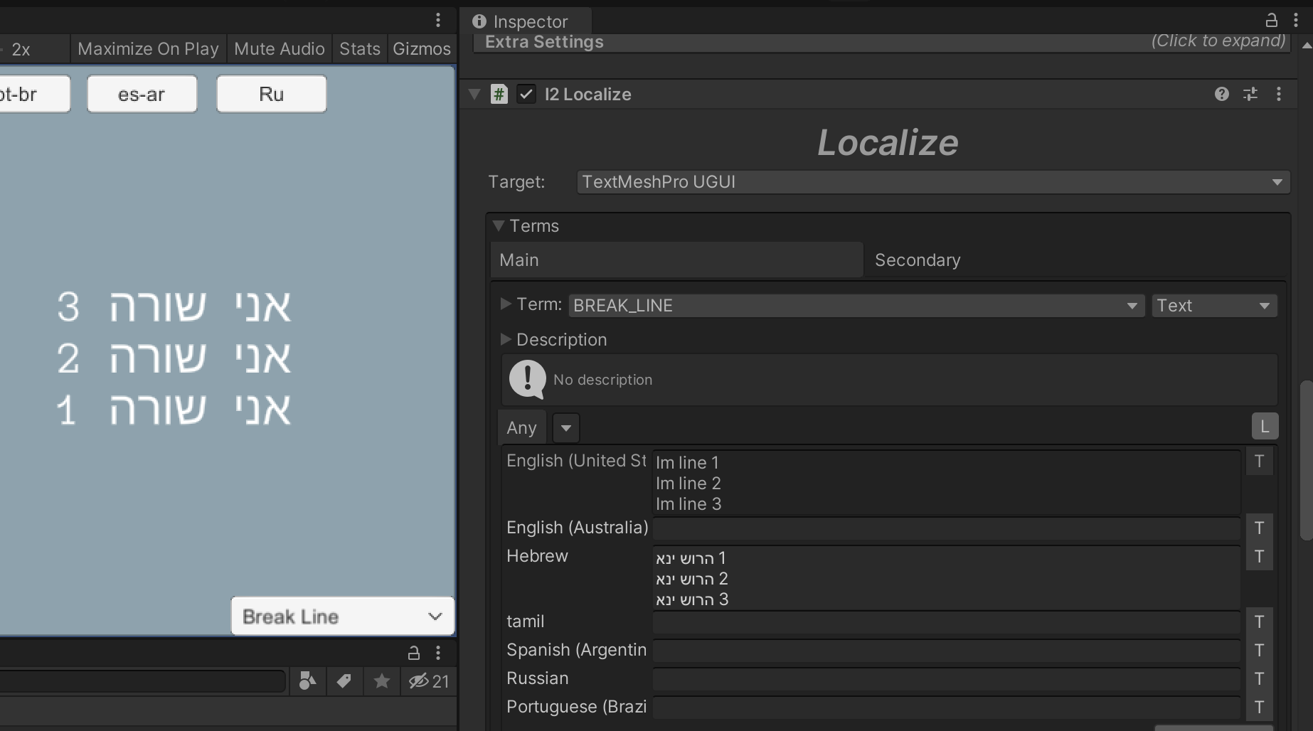

I'm using TextMeshPro objects for my texts. I've added a term with translation that has line breaks.
The Hebrew (RTL language) translations is as follows:
אני שורה 1
אני שורה 2
אני שורה 3
But, it renders the lines in the wrong order (last to first) - see attached image:
Regular Text object (not TextMeshPro) seems to work fine.
Are you aware of this issue? or am I doing something wrong?
Shirly

6 years 1 week ago #4176
by Lavi
Replied by Lavi on topic Using line break in RTL languages rendered the lines backwards
I have found the problem, when you reverse the final text to RTL you don't consider '\n'.
I changed ReverseText() to this and it seems to be working.
public static string ReverseLine(string line)
var len = line.Length;
var output = new char[len];
for (var i = 0; i < len; i++)
output[(len - 1) - i] = line;
return new string(output);
public static string ReverseText(string source)
var len = source.Length;
var outputString = "";
string[] stringSeparators = new string[] { Environment.NewLine };
string[] strSplit = source.Split(stringSeparators, StringSplitOptions.None);
foreach (var line in strSplit)
outputString += ReverseLine(line) + Environment.NewLine;
return outputString.Remove(len);

5 years 2 months ago #4403
by flors
Replied by flors on topic Using line break in RTL languages rendered the lines backwards
Hello,
I have the same problem with arabic. Try to use your code but it has an error: Cannot implicitly convert type 'string' to 'char'
in ReverseText() function, in line:
Does it work in your project)
Thank you!
Thank you!
5 years 2 months ago #4404
Replied by Frank on topic Using line break in RTL languages rendered the lines backwards
Please update to the latest version of I2 Localization.
That line in the latest version iswhich is valid and solves the issue.
output[len - 1 - i] = source[i];Hope that helps,
