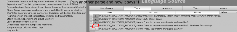

I'm having some issues with running parses.
On occasion, running a parse on a scene will display a used term as '0' until I actually go and manually find it in the scene and select it, then run the parse again.
I have attached some screenshots of the problem happening.

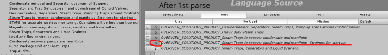

Screenshot 1 - the highlighted term is displaying '0' after running a parse on 'current scene'

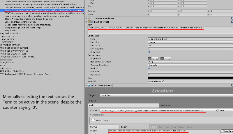

Screenshot 2 - I manually select the text with the term attached
Screenshot 3 - I run the parse again and this time it correctly says '1' next to it
I'm currently working with 44 scenes (big project!), so to have these sort of inaccuracies (unless it's something I'm doing wrong?) is becoming problematic.
I can't go through every single scene and select every text string to make sure the parse is accurate.
I find the above problem also happens with 'missing' keys - opening up the scene and running a parse, then showing 'missing ' keys sometimes shows no results until I manually go and find them myself - then it finds them!
This doesn't appear to be consistent, often it works fine, but other times not.
