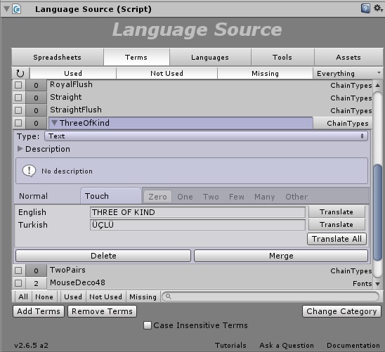

Hi there!
This is my first day with your localization plugin. It is well documented and everything worked fine till trying to translate a runtime editted string:
the Get method returns an empty string so this call returns this output:
On my I2Source prefab there is a Term with ThreeOfKind key assigned. Here is the screenshot:
I guess i am doing something wrong. Can you assist me?
string text = I2.Loc.ScriptLocalization.Get(chainType.ToString());
Debug.Log(chainType.ToString() + " : " + text);the Get method returns an empty string so this call returns this output:
ThreeOfKind :On my I2Source prefab there is a Term with ThreeOfKind key assigned. Here is the screenshot:

Replied by Frank on topic Failed ScriptLocalization.Get Function
From your LanguageSource I see that the term "ThreeOfKind" belongs to the "ChainTypes" category.
So, the actual term is "ChainTypes/ThreeOfKind" instead of just "ThreeOfKind"
try:
try:
string text = I2.Loc.ScriptLocalization.Get("ChainTypes/"+chainType.ToString());
Debug.Log(chainType.ToString() + " : " + text);Are you

10 years 6 months ago #1331
by Sandman
Replied by Sandman on topic Failed ScriptLocalization.Get Function
Thanks for uber-fast response! Your answer worked like a charm.
I knew it was so simple and i was missing something. Can you add this information to FAQ forum section ?
Thanks and Thumbs Up!.
