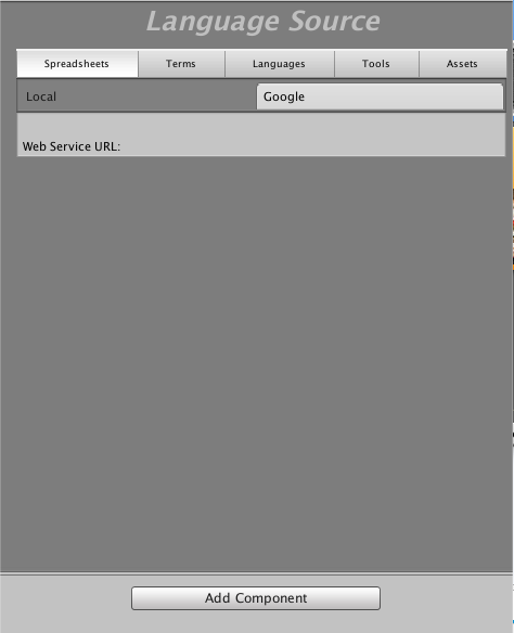

I recently upgraded my unity to 5.3.4p1 from 3.5.1.p1, and "I2Languages" doesn't get localization from google docs.
my version of I2 localization is 2.6.4b2. I also tried to update I2 to 2.6.5a2, but had no luck.
Please let me know what I can do.
Thank you.
Attaching image and error message I am getting.
Thank you.

10 years 6 months ago #1364
Replied by Frank on topic Does not work on Unity3d 5.3.4p1
2.6.5a2 fixes that issue. However, if you try to update unity sometimes doesn't get the latest version correctly and you have to manually delete the package in the cache folder.
Here is also the script that is modified to fix that issue. Please, verify that your script is exactly like this one:
inter-illusion.com/forum/i2-localization...error-in-unity-5-3-4
This is what a user had to do to fix the issue where unity wasn't downloading the package correctly:
So i have to delete the Asset Store's temporary file in 'C:\Users\xxx\AppData\Roaming\Unity\Asset Store-5.x'
The following user(s) said Thank You: ktae13
10 years 6 months ago #1365
by ktae13
Replied by ktae13 on topic Does not work on Unity3d 5.3.4p1
Thank you Frank,
It fixed my issue. I should've looked more carefully before I post it.
Thank you very much.
