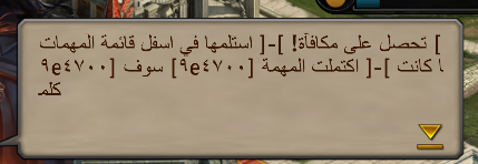

10 years 3 months ago #1560
by messi
Arabic with color code was created by messi

10 years 3 months ago - 10 years 3 months ago #1563
by messi
Replied by messi on topic Arabic with color code
thank you very much,
what I use is 2.4.5 f3,in this version I found another wierd thing about Arabic translation.when I use {num} it will be parse as {num} but when I use {0} ,it will parse as {.}.
I encapsulate a function like this :
public static string GetWithPara( string Term, Dictionary<string, string> para, bool FixForRTL = true)
string _term = LocalizationManager.GetTermTranslation(Term, FixForRTL);
for (var s = para.GetEnumerator(); s.MoveNext()
string token = "{" + s.Current.Key + "}";
_term = _term.Replace(token, s.Current.Value);
return _term;
so I need the {0} keep the same as before,what should I do? Thank you
