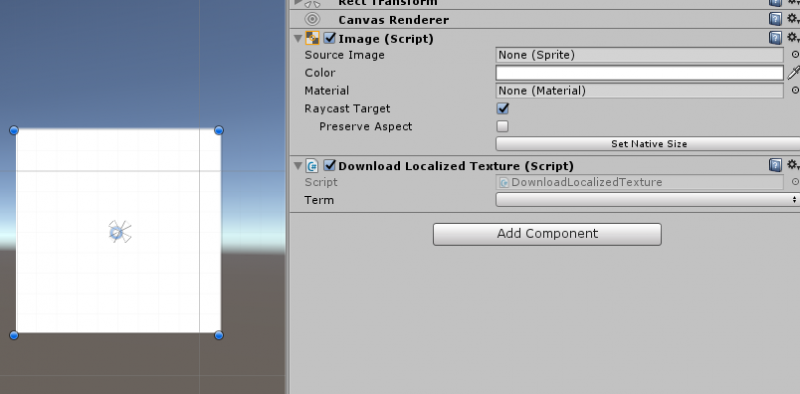

However, if you still need to download images from the web when a localization happens, then you could use the following script.
Just add it to your GameObject containing the Image or RawImage and select the Term.

using UnityEngine;
using System.Collections;
using I2.Loc;
public class DownloadLocalizedTexture : MonoBehaviour
[TermsPopup] public string Term;
public void OnEnable()
LocalizationManager.OnLocalizeEvent += OnLocalize;
public void OnDisable()
LocalizationManager.OnLocalizeEvent -= OnLocalize;
StopAllCoroutines ();
public void OnLocalize()
StartCoroutine ("DownloadTexture");
IEnumerator DownloadTexture()
// Get the localized URL and validate it
string TextureURL = ScriptLocalization.Get (Term);
if (string.IsNullOrEmpty (TextureURL))
yield break;
// Download the texture
var www = new WWW (TextureURL);
yield return www;
// Can't find the image or there is no internet
if (string.IsNullOrEmpty (www.error) || www.texture == null)
yield break;
// Set the value for Image
var imageCmp = GetComponent<UnityEngine.UI.Image> ();
if (imageCmp) {
imageCmp.sprite = Sprite.Create(www.texture, new Rect(0, 0, www.texture.width, www.texture.height), Vector2.one*0.5f);
yield return null;
// Set the value for RawImage
var rawImage = GetComponent<UnityEngine.UI.RawImage> ();
if (rawImage)
rawImage.texture = www.texture;
