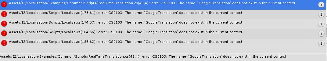

Using Unity 2017.1.0f3
Updated I2 to 2.8.0f3
Assets/I2/Localization/Scripts/Localize.cs(173,61): error CS0103: The name `GoogleTranslation' does not exist in the current context
Assets/I2/Localization/Scripts/Localize.cs(174,57): error CS0103: The name `GoogleTranslation' does not exist in the current context
Assets/I2/Localization/Scripts/Localize.cs(184,66): error CS0103: The name `GoogleTranslation' does not exist in the current context
Assets/I2/Localization/Scripts/Localize.cs(185,62): error CS0103: The name `GoogleTranslation' does not exist in the current context
Assets/I2/Localization/Examples/Common/Scripts/RealTimeTranslation.cs(43,4): error CS0103: The name `GoogleTranslation' does not exist in the current context

I wish it was that easy. I've done that several times. Clean install and update. I'm on the android platform. I can also confirm that GoogleTranslation.cs is there.
