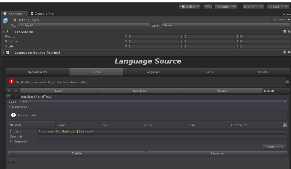

Send failed since rewinding of the data stream fai
8 years 10 months ago #2613
by fidi
Send failed since rewinding of the data stream fai was created by fidi
8 years 10 months ago #2614
by fidi
Replied by fidi on topic Send failed since rewinding of the data stream fai
I'm sorry, in the moment I sent the question I did not see that another had the same problem.
I wiil try that solution.

8 years 10 months ago #2617
Replied by Frank on topic Send failed since rewinding of the data stream fai
That was the fix for the Add Terms to Source not working when clicking it from the LanguageSource instead of from the Localize component.
The fix for the "Send failed since rewinding of the data stream failed" is the following:
change in file assets\i2\localization\scripts\google\googletranslation_post.cs line 122
from
into
The problem is that in different versions of unity the rewind message is different. So, I'm fixing it by making any error related to rewinding, go an fallback to a GET method.
Hope that help,
from
if (errorMsg.Contains("necessary data rewind wasn't possible"))into
if (errorMsg.Contains("rewind"))The problem is that in different versions of unity the rewind message is different. So, I'm fixing it by making any error related to rewinding, go an fallback to a GET method.
Hope that help,
8 years 10 months ago #2619
by fidi
Thanks, that worked!
Regards.
