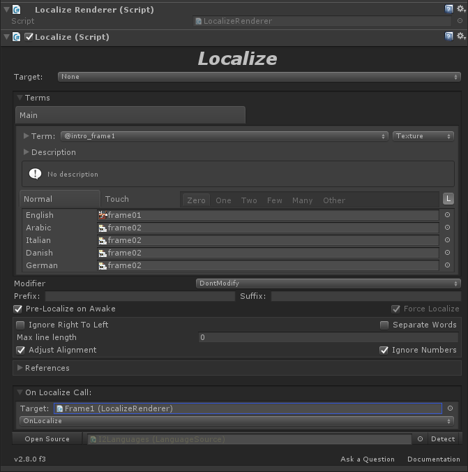

I am attempting to follow the approach suggested in
www.inter-illusion.com/forum/i2-localiza...ith-a-material-on-it
to replace the main material on a Mesh Renderer, but I never see the callback firing.
My Unity components are configured as in the attached and the LocalizeRenderer class is defined as -
UPDATE: while tracing code execution through Localize.cs it would appear that the OnLocalize method terminates as it is not finding a target, which appears possibly inconsistent with the guidance that "even if the component doesn't show any target, it will execute the callbacks"
Any assistance in resolving issue would be much appreciated
[RequireComponent(typeof(Localize))]
[RequireComponent(typeof(Renderer))]
public class LocalizeRenderer : MonoBehaviour
public void OnLocalize()
Debug.Log("Localize");
if (!string.IsNullOrEmpty(Localize.MainTranslation))
GetComponent<Renderer>().material.mainTexture = GetComponent<Localize>().FindTranslatedObject<Texture>(Localize.MainTranslation);
}UPDATE: while tracing code execution through Localize.cs it would appear that the OnLocalize method terminates as it is not finding a target, which appears possibly inconsistent with the guidance that "even if the component doesn't show any target, it will execute the callbacks"
Cheers,
Sigurd

8 years 9 months ago #2649
Replied by Frank on topic OnLocalize callback not firing
You are totally right, in the latest refactoring of the localize flow, that changed the way the Targets were detected and used, that behavior was changed accidentally.
To fix this issue, just move the "if" at line 130, to right before applying the RTL fix in line 157:
i.e. Move this: Assets\I2\Localization\Scripts\Localize.cs (line 130-131)
to line 157
That way, even if there is no target, the callbacks are executed.
I will add this change to the latest beta as well.
Thanks for pointing that out!
if (!HasTargetCache() && !FindTarget())
return;to line 157
return;
bool applyRTL = LocalizationManager.IsRight2Left && !IgnoreRTL;That way, even if there is no target, the callbacks are executed.
8 years 9 months ago #2650
by enghoff
Replied by enghoff on topic OnLocalize callback not firing
Thanks, that's definitely a better solution than adding a dummy GUI Texture, which became my workaround
8 years 9 months ago - 8 years 9 months ago #2651
by enghoff
Regrettably it doesn't seem to resolve the issue
