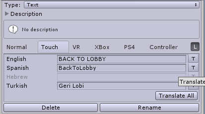

I installed the latest version and I have a problem
1) there are not the single buttons for the translation of a single language I can only change them all together! If I correct a term of a single language these are changed if I press on "Traslate All" !!!
2) however the behavior of the translation is abnormal look at this video
www.micronet-software.com/I2/Untitled%20Project2.html
it is advisable to restore as in the previous versions 1 button for each language
thank you
thank you

Replied by Frank on topic New version the translation is wrong!!!
That was a bug when using Touch translations (having platform as Android/IOS, etc). The plugin thought all fields were empty because the "Normal" translations were empty.
I made proper a fix for this in 2.8.2a4.
A workaround you can quickly use is to replace line 247 in Assets\I2\Localization\Scripts\Editor\Localization\LocalizationEditor_Terms_Description.cs
fromintoThat will force only to translate empty translations.
The issue there is that the Normal translations are not empty, so, when the Touch translations are emptied, it takes the value from the Normal. This is very confusing at the moment given that there is no way to see from where that translation is comming.
The next think I'm working on, is in improving the way the Input variations work ( trello.com/c/slJ2P9aM/3-extend-input-specialization ).
As part of this, the system should be more understandable and easy to follow.
The buttons were removed to allow for more space, but I'm seeing that sometimes this brings confusion, specially with that bug that overrides everything. So, in 2.8.2a4 I restored the buttons, but instead of naming them "Translate", I just placed a "T" with a hint text saying "Translate" when you hover above them, that will still give enough space while giving flexibility on which language to translate.
from
if (string.IsNullOrEmpty(termdata.Languages[i]) && source.mLanguages[i].IsEnabled()) if (string.IsNullOrEmpty(termdata.GetTranslation(i)) && source.mLanguages[i].IsEnabled())2) however the behavior of the translation is abnormal look at this video
Last edit: 8 years 7 months ago by Frank.
