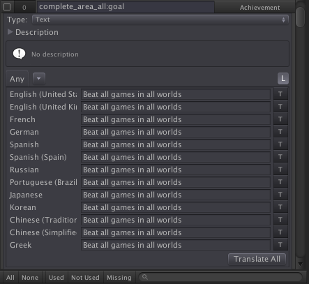

I'm having this issue which comes up so often that it's become a workflow issue and I'm not sure what makes it happen. Essentially we've got 11 languages and they are in the process of being translated. Most of them are blank and fallback to english. Some will stay blank, even when translations are complete. There's a bug when using the Unity Editor that causes the Language Source to copy all the fallbacks into the blank fields in the I2Language prefab. When this happens we have to quit Unity without saving. If we accidentally saved, then any work we did on the prefab has to be thrown out and reverted to our clean copy in our source repository or we Import/Replace from our Google Spreadsheet.

Example:

OK @Frank, I found a consistent repro case of this, but I suspect it also happens in other cases. All I have to do is make a build (like for iOS or Standalone) and then when I look at the LanguageSource after, any blank translations get replaced with their fallbacks. Happens every time I make a build.
